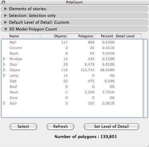

THE FILE
1.3MB compressed. render size: 1400x918 pixels. lightworks photorender settings were all 'best' with all effects on. 'sun', 'ambient' and 'lamps' on, 'camera light' off. realistic sun used with a sample rate of 64 and divergence of 2º. there were 13 window lights and 1 additional sun object (The Dwight Undersun™). the polycount stats for the file are attached as a screenshot. no other apps were running. there was a lot of glass - and therefore reflectance - in the render . . .
