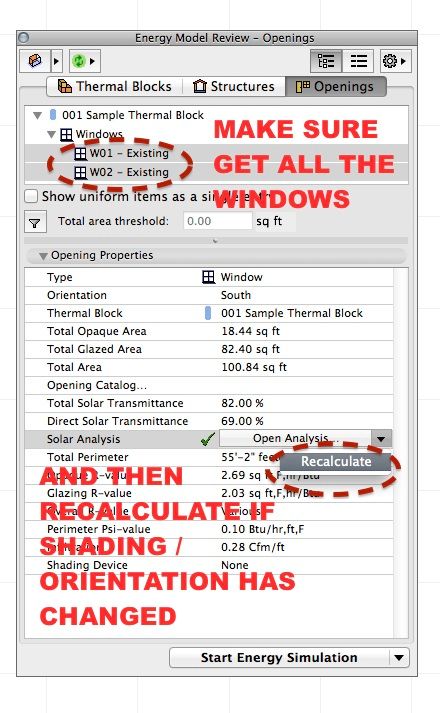

I just wanted to post a follow up on the issue I was having in previous versions and say that PHYSICAL SHADING IS NOW TAKEN INTO ACCOUNT IN THE ENERGY BALANCE REPORT in AC18 6004, though It's important that you understand how to update openings to make sure it makes it's way into the energy balance report (see screen shot below).
Unlike the zones which seem to know when something has changed and warn you that you should need to update the zones, you also have to refresh the solar analysis by recalculating any window which has had a change to it's solar exposure (size, shading, orientation etc), so while it's a bit clunky in terms of interface, it does now work if you change an overhang the solar analysis of model based shading makes it's way into the energy balance report - YAHOOO!
It would be nice if there was a one step refresh everything button for smaller projects, though I would guess as projects get larger having the ability to separately control what is being recalculated could become very important.
See attached screen shot of required step to make sure shading makes its way to the openings solar analysis / energy balance report.
I can't vouch for some of the other more detailed issues others were having since this was a show stopper for me to even start using the tool, but am hopeful that this is a sign of general improvements to the tool.
A shout out to Miklos and his team - thanks for making this happen in AC18! - I'm excited to start using it!
