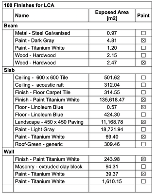

I have created some schedules to total areas of certain elements by surfaces.
The idea is to assign building materials with surfaces assigned to them, and schedule out the finishes by area.
This is what it looks like so far:
As you can see, there is some work involved in checking that all objects have their 'proper' surfaces applied.
It means that instead of using existing paint finishes for example, I create specific finishes for fibre cement panels, internal wall paint, and architrave/skirting colours etc. There is quite a bit of rationalisation to be done, but it ought to work.
There is another schedule for internal walls and another for external walls - again calculating areas of finishes. I could put them both in a combined schedule, but I have a lot of wall types, some are composites and some are complex profiles. I'm not that competent at schedules to make them do what I want first time every time yet, so I would rather make separate ones.
