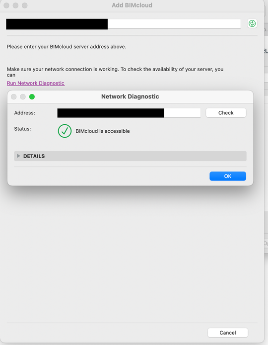

Hi Everyone,
Last week our uni issued the new BIM server for our graduation project. I'm able to login on the BIMCloud browser website, however, when connecting to the server on Archicad27 the server diagnostics indicate the BIMCloud server is accessible. When I try to log-in, it gives me the error:
An Unknown Error Happend: Cannot connect to BIMCloud
Other Teammates also use MacOS and have no problem logging in. The server is only available on version 27 Could this be a user-specific issue, or is this something faulty with my server connection?
Any help is greatly appreciated!! Thanks.

@lenne_koppers, please contact your local Graphisoft support representative. Archicad logs contains the details of the connection issue, so further investigation based on them will surely help.

ST2025
If you are on a Mac, do the below:
Add Archicad 27 to 'Full Disk Access' on the device, and allowing Archicad 27 through the local network.
May be with the update on MacOS, it has blocked the access.
Worked for us.
