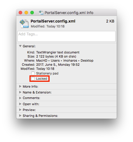

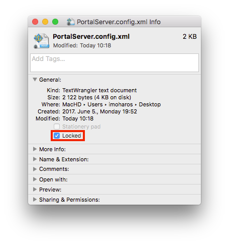

  2. Right click on the PortalServer.config.xml file on the desktop, and select Get Info.
  3. In the Info dialog, under the General tab, uncheck the Locked checkbox, then close the Info dialog.

  8. Right click on the file and select Get Info, check the Locked checkbox then close the Info dialog.

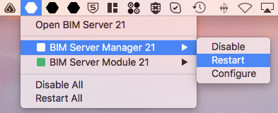

  10. Restart the BIMcloud / BIM Server Manager from the control icon from the menubar.
