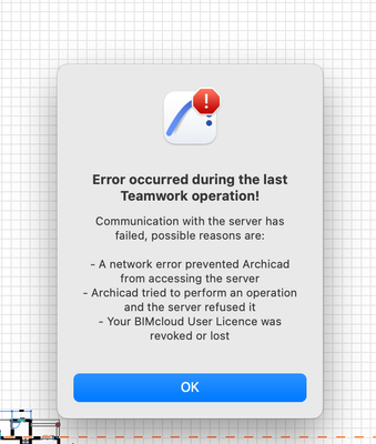

here is a small sampling of the t/w warnings I have been trouble shooting the past week. This feels like something is broken... or theres something else at play here (my tinfoil hat is on pretty tight right now). And these are about 1/4-1/2 of what I've been sent:

if basic t/w opperations require an IT expert to trouble shoot and repair, it is bad software design. And even then, I'm not seeing any deep IT solutions that work.
the software works, or it doesn't. And all too often, it just doesnt work.

Installing and maintaining a (Windows Server based) network is no easy task. The fact that someone is using Archicad doesn't make him or her an architect. For that reason basic knowledge in network technology and how all the different gears are fitting together is essential. Because it's called "bimcloud basic" doesn't mean it's easy.

Torben, I'm not trying to pick a fight. I'm not trying to say that you aren't helping. I'm glad you have the IT experience to make it work for you.
But I do have to say, it IS GS's fault if the software requires 20 years of IT and network know-how to make their tool work. I'm sorry, but how many people driving a porsche are certified porche mechanics.
I get that you are out of the convo. I do appreciate the feedback and attempts at finding a solution; and you are right, the discussion is leading nowhere. I have an IT team, a very capable one. I don't know what it takes to make this work, my IT team doesn't know what it takes to make it work. But in my 20+ years of using Archicad, I have not run into this much unreliability in their tools.
example; here is the 2nd t/w issue today from one of my designers. Maybe it IS my fault; I am admittedly not an IT expert. And I'd wager, maybe aside from you, most other Archicad users are not either.

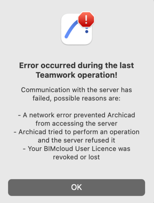

We only just started to have this issue last week, and it has now happened 3 or 4 times on the same project to different people working in teamwork. We haven't been able to get the error to go away and are having to save out a pln and reshare the teamwork project, often meaning someone loses their work since its being simultaneously worked on and one person can't share their changes. Archicad users for over 15 years and the last five years have been the worst with warnings, run arounds and lack of fixes. We're current with updates and we're on their current server. Fast internet speed as well. The odd thing is it isn't giving the warning on all projects, we could have two open and one won't send changes and the other will. Which seems to eliminate all of the potential warnings in this message.
We did receive this link from the support desk and they recommended to save out the issue file and do a repair and reshare. We're a small company and don't have an IT department so issues like this cause a lot of overhead and disruption to our workflow, it's unfortunate how common these issues are becoming. And I am shocked to see how many other people are having this issue and there isn't more support around it.

@Allyn This isn't odd for this error, we also have it only on certain projects and even only with certain users.
Another evidence that it has probably nothing to do with the setup but is a bug from ArchiCAD or the Bimserver.

here's one that has popped up 3x this week in 3 different projects. No direction, no hints, no intel on what is causing it...
A link to a log file would certainly be expected there… not sure how they expect the user or the programmers to diagnose this otherwise.   I feel your pain, Patrick.
