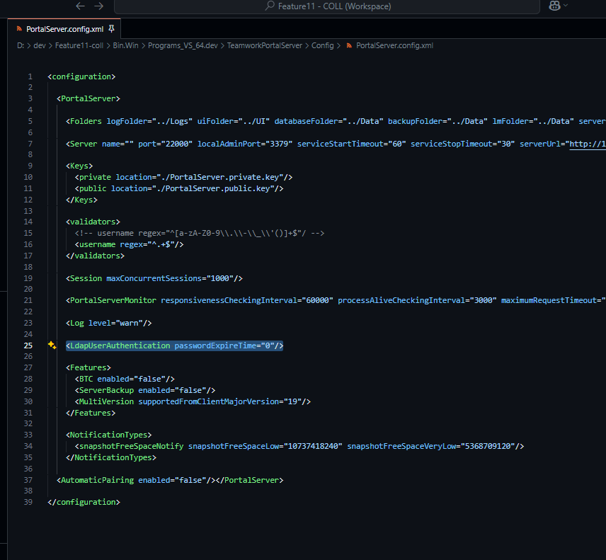

Bimcloud is local, not SaaS. Ldap sync has been used for years, only after 2024 installation the problem appeared for some users. Few of them did not meet the password requirements, but even after they changed their passwords they are denied access.

The idea is that there is a chance, the portalServer saves the incorrect password in case of an invalid login attempt. (Graphisoft hasn't found the bug yet, but they assume this can cause it.)
Workaround:
The following parameter should be set in the PortalServerConfig.xml file:
<LdapUserAuthentication passwordExpireTime="0"/>
To apply the above workaround, follow the steps below:
  1. Ensure no-one is actively working in the teamwork projects
  2. Stop the BIMcloud Manager with the help of - https://community.graphisoft.com/t5/Teamwork-BIMcloud/Start-and-Stop-BIMcloud-manually/ta-p/303834
  3. Locate the PortalServer.config file, which on Windows by default is stored here: C:\Program Files\Graphisoft\BIMcloud\Manager-XXXX-XX-XX\Config and on macOS stored here: Applications/Graphisoft/BIMcloud/Manager-XXXX-XX-XX/Config
  4. Open the PortalServer.config file in a text editor of choice and copy the <LdapUserAuthentication passwordExpireTime="0"/> parameter into it and save the file. (See also the image attached)
  5. Restart the BIMcloud Manager and then monitor if users still experience access issues to the teamwork projects
Please note the Manager-XXXX-XX-XX indicates when the BIMcloud was installed e.g. 2025-03-21
Please let me know how you go. Thanks.

Hi All, I updated the PortalServerConfig.xml file over the weekend, no issues so far, but it is still early days. I think we need a few weeks without an incident to be confident that it is working.
I will keep you informed.
