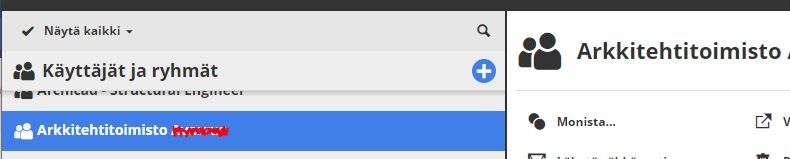

I have BIMcloud SaaS group with 8 member. They have "Full access" role now and i like to change it to self made custom role ....i can't find where i can set that custom role active for group?

If you want to grant your custom roles to the members, the easiest is:
  • On the Users page, create a new group. Add your members.
  • On the Project page's root (do not select any of the folders or files) click on the Access panel on the right side and add your new group with your custom role.
Keep in mind that the members should have visibility permissions over the files, else no matter what permissions you gave, they can't use them (as they can't access the files). I also strongly suggest to keep the default permissions and don't delete them unless you're 100% sure on what you are doing. Else, you can easily lock out yourself from your BIMcloud.
