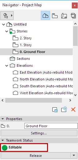

Navigator icons and status
Use status icons (like green dots) and quick-action buttons for reserve, request, or release in the Navigator. Most helpful for managing layouts, views, or when you need to resolve access fast. In a Teamwork project, a green dot next to Navigator items means that the item is reserved by you.
The Teamwork Status panel at the bottom of the Navigator (Palette only) also indicates whether the selected item is: Editable, Free for Reservation, Reserved.

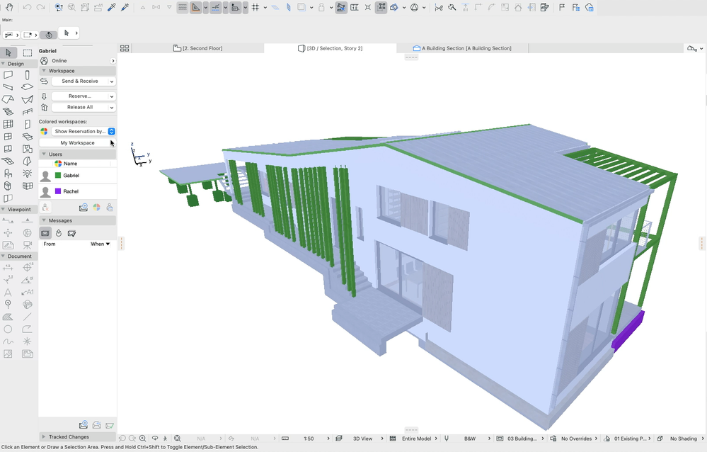

Colored Workspaces
Shows ownership and status by color in any view. Ideal when you want a full project overview—great for larger teams or when managing many elements at once.
Colored Workspaces apply unique color schemes to elements based on their reservation status or current owner. You choose the color scheme from a drop-down menu in the Teamwork Palette, and the visual effect stays consistent as you navigate different windows and views—so you’re never in the dark about who controls what
Access Colored Workspaces from the Teamwork Palette (Window > Palettes > Teamwork).
Available Color Schemes and Their Uses
Color Scheme Option What It Shows Best For...
Highlight My Reservation Your reserved elements in Highlight color; others in Passive color Quickly spotting your own edits in a busy model
All with Original Color All elements in their normal colors (default) Reviewing the model as it will appear in documentation
Gray Out Unowned Workspace Your reserved elements in original color; everything else grayed out Focusing exclusively on your work area, ignoring others’ edits
Show Reservation by Users Each user’s elements in their assigned color; unowned elements in Free color Coordinating across large teams, instantly seeing everyone’s contributions
Own/Free/Others’ Workspace Your elements in your color, free in Free color, others’ in Passive color Balancing between available, yours, and teammates’ work
Requested by Me/From Me/Others Your requests and requests to you in distinct colors; others in Passive Managing and responding to edit requests
Highlight Tracked Changes Elements you are tracking highlighted Reviewing and approving revisions

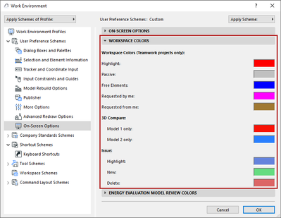

Customising workspace colors
You can adjust all workspace-related colors in Options > Work Environment > On-Screen Options. Categories include:
  • Highlight (your selected or reserved elements)
  • Passive (elements belonging to others)
  • Free Elements
  • Requested by Me and Requested from Me
User color assignments can also be customized. By default, user colors are set globally by the administrator, but anyone can override them locally for better personal clarity. This is done by selecting a user in the Teamwork Palette and clicking their color icon. A color block with a missing corner indicates a local override

Practical Scenarios
    • When reviewing a floor plan:  Use Show Reservation by Users to spot overlapping work areas at a glance.
    • When editing in 3D: Highlight My Reservation helps you focus only on your current edits, minimizing distractions.
    • When managing requests:  Requested by Me/From Me lets you prioritize and process incoming change requests visually.
    • When tracking revisions:  Highlight Tracked Changes draws attention to elements under review.
