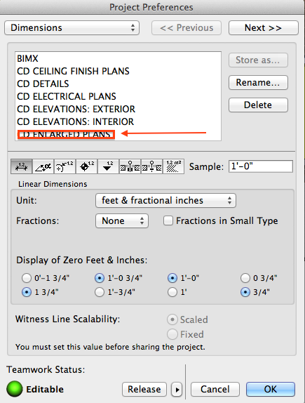

After reserving project preferences and changing them successfully, each day when the project is reopened (after it was sent back to the server the day before when closing) the preferences go back to previous settings. All other changes made to the project are saving fine without issue.

I'm working in Archicad 18. Specifically, it's the dimension settings under Options > Project Preferences.
Stress Co_
To clarify... the setting displayed in this list, and then it was gone
when you reopened the project?

Yes, that is correct.
