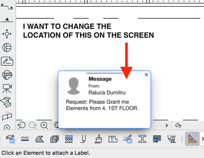

I want to set a specific location on my monitor for the "request" Pop-up window.
I seems to only show up on the bottom left.

Ernest Atanasiu
Just drag the window by the top line above the Message text.
Next message will be in the desired location.

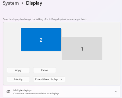

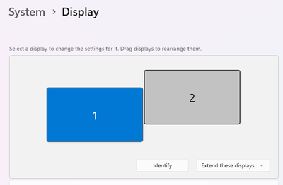

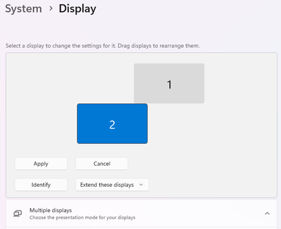

I was struggling with this pop-up notification for a while in our office, and your workaround to "just choose the Workspace Scheme and change that to a default setting, but that will alter the position of all palettes and toolbars" didn’t work for us.
However, I managed to find the location of the pop-up request notification by moving the second screen around the first main screen. When I found it, I moved it to the middle of the main screen, and now it remembers the new location.
A suggestion for everyone is to find and locate the pop-up notification window in the middle of the main screen; this way, even if you change or add monitors, the location will be the same.
