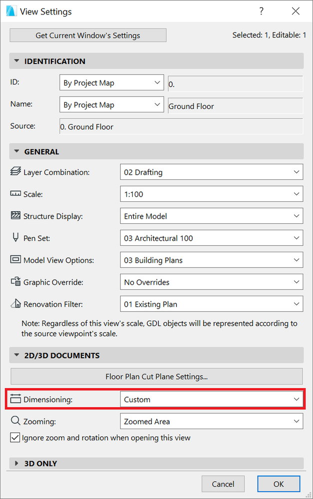

Issue
When a user modifies an existing Dimension Standard or creates a new one which is not stored in a project, that is the Store As choice is not used, the dimension standard appears with a name "Custom." As soon as this user creates a new View that uses this Dimension Standard with title "Custom" and sends modifications to the BIMcloud Server, the following problems will arise:
  • New team members will crash on trying to join the project,
  • Other team members will crash as soon as they Send & Receive.
Example of a View where the "Custom" named Dimension Standard is set.
This issue affects only Teamwork users running on the ARCHICAD 22 6001 update.
