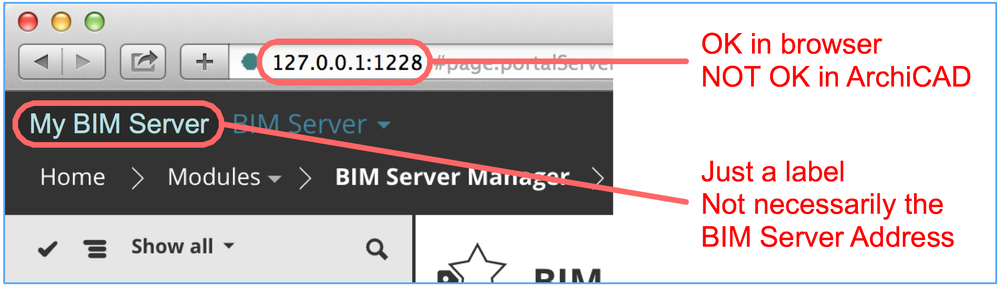

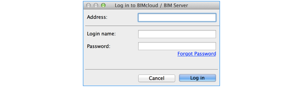

What is my BIM Server address?
BIMcloud / BIM Server login dialog within ARCHICAD.
  !!!  DO NOT USE - 127.0.0.1 !!!  DO NOT USE - BIM Server Name
BIM Server Manager in web browser.
What is a valid address? It depends on your needs:
[qd_list]
  1. I will only use BIM Server within in my office.
    • USE - Private IP Address or Domain Name
  2. I will use BIM Server in my office and outside the office. I have a VPN.
  3. I will use BIM Server in my office and outside the office. I do not have a VPN.
    • USE - Static Public IP Address or a Fully Qualified Domain Name
Proper Address Format
Tip: You may omit the "http://" prefix when typing the address. Both your browser and ARCHICAD will amend the prefix automatically after entering the computer address and port.
