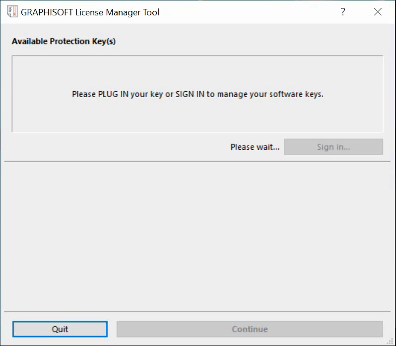

When trying to sign in to Graphisoft's License Manager Tool (LMT) with a Graphisoft ID on Windows Server, LMT keeps waiting forever and does not let any user log in properly to download licenses.
Why is this happening?
Graphisoft's License Manager Tool's (LMT) sign in is based on Microsoft's Internet Explorer. When the tool is not able to sign in users to their Graphisoft ID, it is most probably because Internet Explorer's Enhanced Security Settings are enabled on the computer, which block Graphisoft's web content to be downloaded properly.
