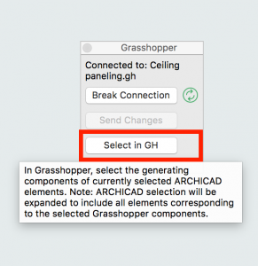

  • If the connection is live, by selecting an ARCHICAD node in Grasshopper will select the generated elements in the ARCHICAD project.
  • If the connection is live, then clicking on elements in ARCHICAD we can select the generating node in Grasshopper from the Live connection palette.
