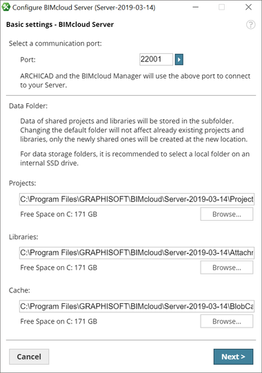

  1. Open the Tray Application to reconfigure your existing BIMcloud Server settings.
  2. Select the BIMcloud Server you wish to configure and choose Configure.

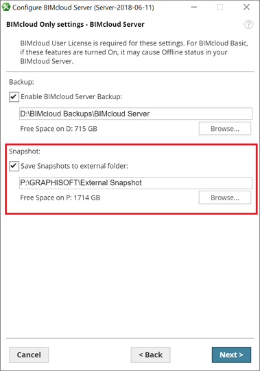

  1. Click Next to go to BIMcloud Only settings.
  1. Check Save Snapshot to external folder and browse for a target path.
  1. Click Next to continue configuration process.

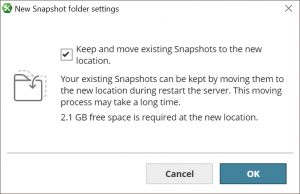

  2. BIMcloud Server Configurator offers users to keep and move their existing snapshot files to the new location. Click OK.

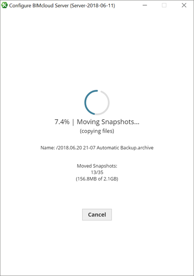

During this step, BIMcloud copies all existing Snapshots from their original location to their new one. In case this setting is unchecked, existing Snapshots are deleted from their current locations and only new Snapshots are created on the path you set in step 4.

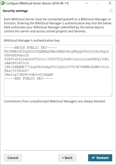

  1. On the Security settings click on Restart.
  1. Click OK to finish process.
wp-content_uploads_2017_10_Warning_18x18.png WARNING:
Depending on the size and number of existing snapshots, this process may take a long time.

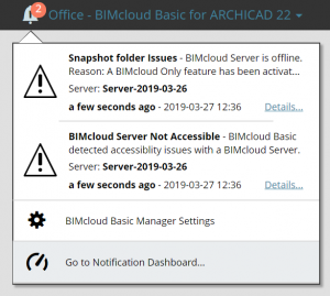

What if the feature is enabled on BIMcloud Basic Snapshots on external storage require BIMcloud User Licenses. When feature is enabled on BIMcloud Basic, you get two notifications on the Manager web interface that your BIMcloud Server is not accessible, because a BIMcloud Only feature is enabled on your setup.
Run BIMcloud Server Configurator again to disable this feature.

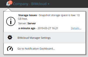

Not enough free space on external storage BIMcloud has a built-in notification to warn you in case the target folder does not have enough free space to store your snapshots. By default the first notification arrives when your free space is lower than 10 GB. This message will show up each day until you free up enough storage.
In case your external storage has even lower free space than 5 GB, another notification appears.
It is recommended to always have as much free space on your external storage as large your Projects folder on your server computer, or at least 50 % of the size of this folder. This ensures your BIMcloud can create snapshots without any issues.
