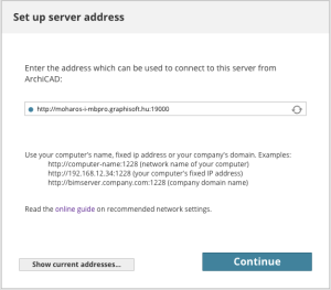

Install the BIM Server using the installer from the DVD/downloaded from the web. At the end of the installation, the configuration will be done in your default web browser. If you face any difficulties within the browser, try an alternate supported one. You can copy paste the url over to the new browser. During the server set up you can add a primary address which can be used to connect to the server from ARCHICAD. You can add this address manually or you can use the 'Show current addresses...' button where you can choose from existing addresses which the application automatically detected.

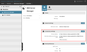

Make sure to set up different ports for v18 and v19. A fixed IP address is required and a DNS name is recommended for the computer that runs the BIM Server. If the server is accessed from both the local area network and over the Internet make sure to add all the different addresses (internal IP, external IP, domain name) in the BIM Server Manager Connection settings.
