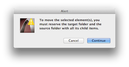

View and Layout Reservation
In Archicad 18 when arranging views and folders in the View Map both the source and target folder has to be reserved by the user. Previously it was possible to move a folder into another without reserving the target folder. This could lead to logical anomalies, e.g. one user moving folder A into B and another user moving folder B into A at the same time.
