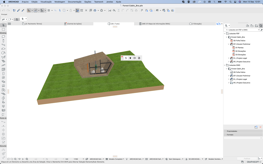

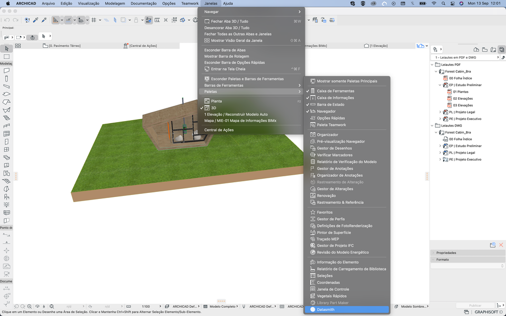

O plug-in Graphisoft Archicad Exporter apresenta a funcionalidade Direct Link, que permite sincronizar os seus arquivos do Archicad com o Twinmotion. Clique aqui para baixar o plug-in Graphisoft Archicad Exporter.

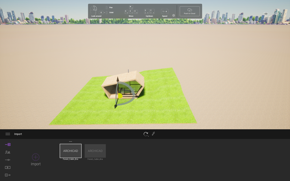

Como sincronizar os arquivos?

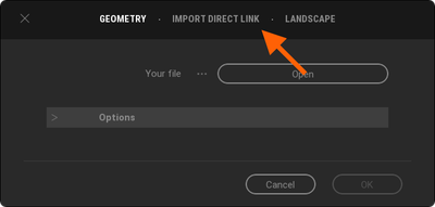

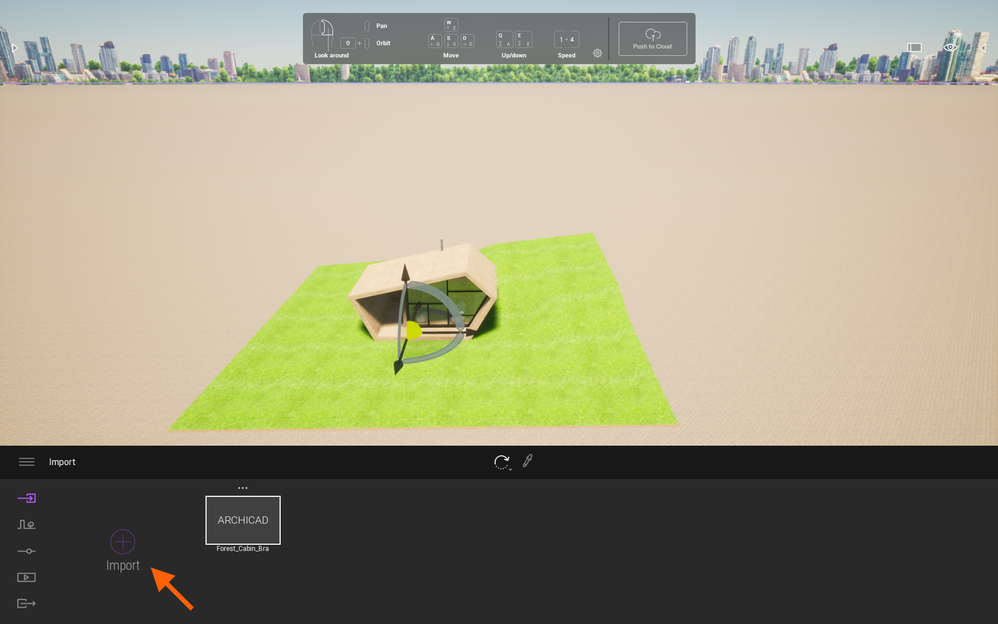

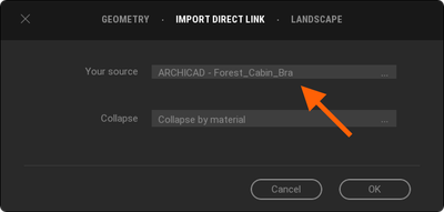

1 . No Twinmotion escolha
Import > Import Direct Link > Your Source > Archicad.
![Screen Shot 2021-09-13 at 12.00.13.png Screen Shot 2021-09-13 at 12.00.13.png](/t5/image/serverpage/image-id/4818iF38C234C3B3A3861/image-size/large?v=v2&px=999)
![Screen Shot 2021-09-13 at 12.00.36.png Screen Shot 2021-09-13 at 12.00.36.png](/t5/image/serverpage/image-id/4816iB40A752FB64501C0/image-size/medium?v=v2&px=400)
![Screen Shot 2021-09-13 at 12.00.50.png Screen Shot 2021-09-13 at 12.00.50.png](/t5/image/serverpage/image-id/4817iE067BD7BD3396B1B/image-size/medium?v=v2&px=400)
