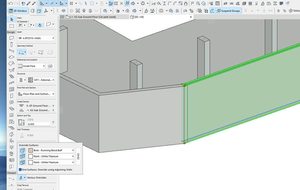

Hi everyone, please help with an issue.
Everything I model shows grey as in the attached image, regardless of what materials I assign to the elements.
There are no graphic overrides, I have selected detailed shading to be shown and hardware acceleration is selected.
I never encountered this problem in all the years I'm using Archicad, so I don't know where the problem is.
Thank you.

Check your 3D STYLES  settings. Someone may have overridden a setting in the "Detailed Shading".
The other option is Renovation Settings. For example you may have Graphic overrides in the renovation settings active that are modifying existing elements to grey.
