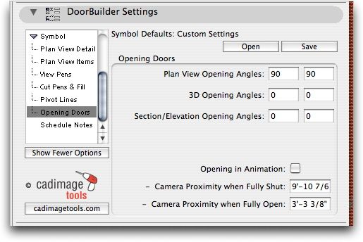

I'm in the process of creating a fly through. As it stands now i am going through several doors. Is there a way for the doors to open as the fly through approaches or have them opened the whole time?

Standard library objects do not do this, but certain aftermarket objects can be animated.
If you have any facility with GDL, it is easy enough to relates the door opening angle to a specific frame in the animation.
Some door objects allow for a fixed open angle.
Door and Window Builder doors, for example.
Dwight
Yes! I found it. But it remains a cheezy effect.
Dwight Atkinson
Here is a thread in which I wrote down how to do it in you existing objects if you are familiar with GDL:
http://archicad-talk.graphisoft.com/viewtopic.php?t=2751
