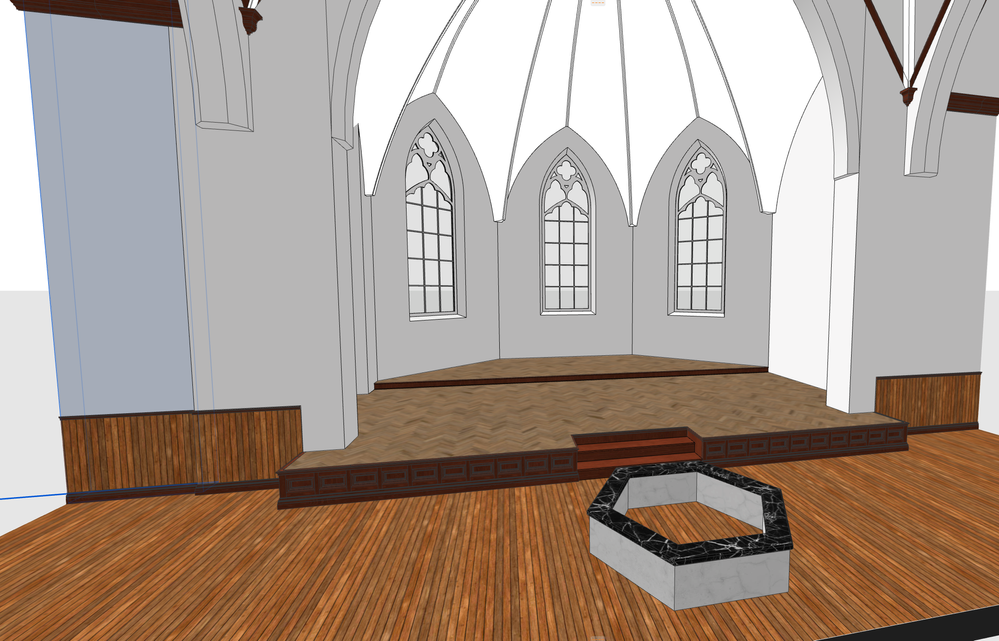

As you can see in the two screenshots (one on model view, and another a cinerender rendering), cinerender is rendering strange artifacts (in red dashed lines) on objects that are adjacent to rhino-grasshopper made closed polysurfaces. All walls in these views are AC. The window openings are made with *solid* morph solids, subtracting from the wall elements. The rhino element (a *solid* morph once in AC) is the vaulted ceiling, which was then subtracted from with the walls below (and still solid after the subtraction). This was done to prevent slight overlap between the morph and wall, and so create the lines of intersection in the model's views including elevations/sections, etc.
It does seem that even with the grasshopper/rhino objects off, the artifacts still happen in the rendering. So possibly its because of the solid subtractions' geometry? I've extended and trimmed the faces of the solid subtractors to the faces of the walls to be sure they are flush, but that has not helped.
Ultimately, I'm not sure if its the rhino-grasshopper objects, or the solid subtractors' geometry. But either way, any help on the artifacts would be appreciated!

I have no experience of the Rhino-Grasshopper connection so I can't give any advice on that. But rendering artifacts like the ones on your picture often appear when using soft edges on morphs and in gdl objects. If the walls in your model are morphs try to set all edges to "Hard" and render again. For gdl objects you need to open the script and change all status values or mask values depending on which command is used to generate the 3d.

Hi @Karl Wir_n  — thanks for the reply. The wall that is creating those artifacts is still a wall, not a morph, but the window hole is a morph that is subtracting from the wall. The morph-bool-subtraction is already set to hard edges, so that seems to not be the problem.
