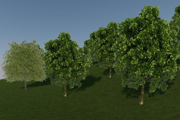

Deciduous Trees 18 with CineRender
I don't know if this is expected behaviour or not but if we choose a ready scene (Outdoor Daylight Medium in this case) the alpha transparency seem to fail and a grey translucent rectangle betrays each billboard image.
Turning on Physical Renderer, however (next image) solves the problem.
Any reason why this is happening?

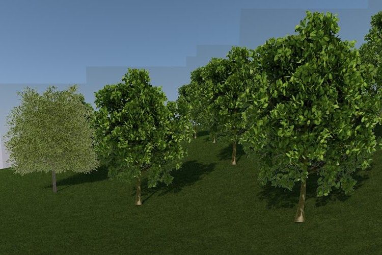

vistasp
Mentor
With Physical Renderer turned on.
For scenes, where such objects are visible we strongly recommend to use the Physical Render engine. During the beta test of ArchiCAD 18 we tried to find a solution for this, but it is related to the C4D engine. We reported this to Maxon, so I hope in the long run they will be able to optimize the engine. Until then the best is using the Physical mode.
