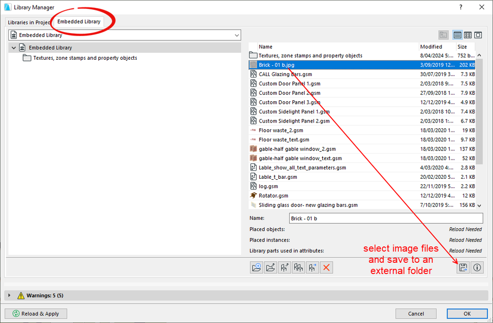

They are either in a library that was loaded in the other project (the one you copied the attributes from).
So you just need to load that same library in your new file.
Or they are in the Embedded Library of the original file.
In which case you need to save them out to a folder on your system.
Then load that library (folder) or add them back into the embedded library.
Best to load as a separate library as you can use it for any other file as well.

Open the library manager of the original file and also in the new file.
Compare the two to see of there are different libraries loaded.
If the loaded libraries are different, you need to load the same libraries in the new file - one of them may have image files in it.
Also, have a look in the Embedded Library of the original to see if the texture files are saved in there.
If they are there, then select them all and save to a folder on your hard drive.
Now in the new file, you load that folder as a library.
You can always post screen shots of your Library Manger from the original file.
Both 'libraries in project' and the 'embedded library'.
I may be able to spot where the image files are.
