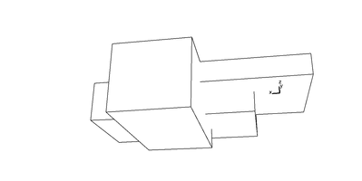

Is there a way to set up a full white model? I am using a predifinied "White model" from 3D Styles, but even with the shadows off, I have shading on ceilings.

If you switch to Vectorial engine, you can switch off shades coming from surfaces and get a completely white modell.

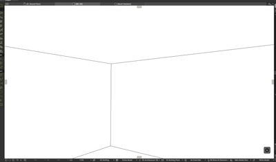

Hi @Rhea,
If you would like to achieve completely white surfaces, you can change a setting in 3D Styles. It’s best to start by creating a new 3D style for this purpose, so you can use it at any time.
You need to change the 3D Engine setting to Vectorial Engine, and then turn off Sun Shadows and Shade surfaces using Sun. Additionally, you can enable Monochrome Model and even unify the Sky Color and Ground Color in the Background settings.

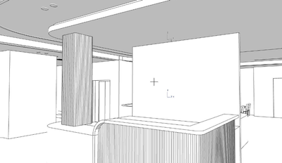

Then, you’ll get something like this in your 3D window:

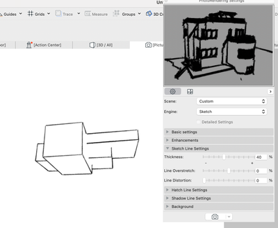

Alternatively, you can experiment with rendering using Sketch mode and different pencil settings:
Hope this helps,
