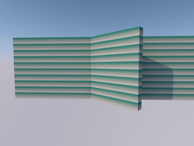

Colorizer, Filter, Fusion, Layer, Posterizer: these are texture options that are built on other textures so there may be inconsistencies
Posterizer - Fresnel
Cinerender Redshift

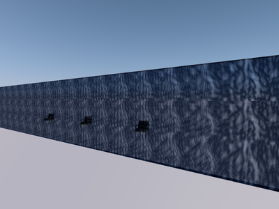

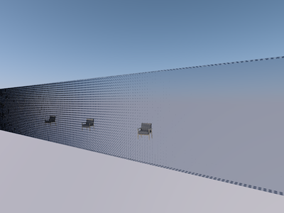

Procedural: mostly misalignment of the texture
Water
Cinerender Redshift

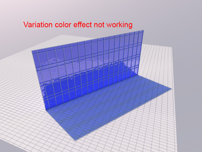

Variation
Cinerender Redshift

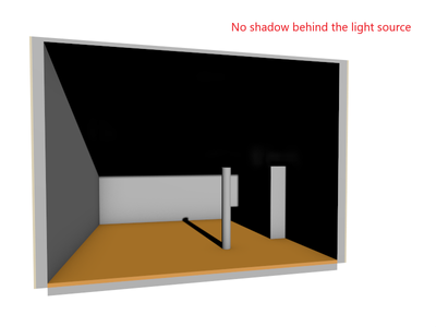

Parallel Light: there is no shadow behind the light source in Redshift
Cinerender
Redshift

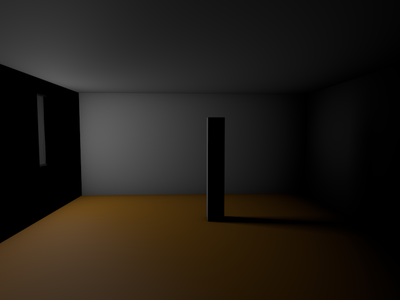

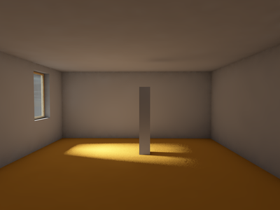

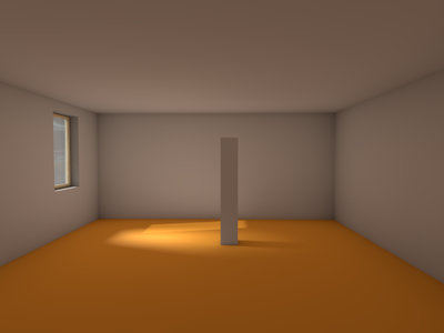

Window Light: the light source does not illuminate nearby surfaces without Global Illumination, or becomes too bright.
Cinerender
Redshift
Sun Object: it is not entirely similar to Cinerender
Cinerender
Redshift

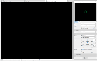

it looks promissing and im looking forward to use it but for now I struggle with redsift render because it produces only full black screen. Where could be the problem?

I have tried simple test scene which shoud be finished in seconds, it shows that render is finished but is black. I have vaited 20 min but nothing apeared.
pdimova
I have the same problem. Full black screen on one of the computers I use. And a Warning! "Your hardware configuration does not support Redshift by Maxon" on my laptop.

From my own experience while testing Redshift, lights work very differently in comparison with Cineware. It will require some adjustments to the scene (in terms of lighting and materials) to get the same result.
Furthermore, the system requirement (especially Graphics card) is very high also. To get the best out of Redshift, apart from making adjustments where it's necessary, a mid to high-end card is definitely needed.
We also published the system requirements for Redshift here in case you missed it.

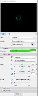

Robert Nichols
I'm confused - not seeing any options for Redshift rendering after having upgraded. The new build is 4013, right? I don't see a Redshift option in the Engine popup in Photorendering Settings dialog. I've checked that I'm using default OEM Work Environment profile. What am I overlooking?
iMac, Mac OS 11.5.2
64 gb RAM
AMD Radeon Pro 5700 XT 16 gb
Lukas Zeleny
Hi Robert,
you can find it in Render section of Photorendering window not  in Engine.

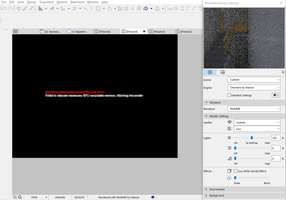

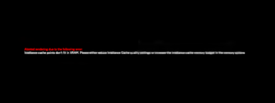

proev
I get the same black window with an error message that is so difficult to read, even when I saved the render I zoomed it wasn't big of a help. However there is a part in the message that says 128MB and when I looked at my graphic cards, it's the dedicated GPU memory of the Intel processor internal graphics. Somehow Redshift is trying to use the onboard graphics and is unaware of the existence of my second Nvidia GPU. And I think I'm right because finally I succeeded in rendering very small frame of just 320x240 pixels, 480x360 also but when its up to 640x480 I get error again(18-05) r.12t - Picture1 (2).jpg320x240.png640x480.png
Minh Nguyen
Graphisoft Alumni
Graphisoft Alumni
Hello,
If you have an Nvidia GPU and an integrated Intel GPU, it might be the case that the Nvidia Optimus kicks in to save power in certain situations. You may want to take a look at this article about how to force an application to run with the dedicated GPU.
Best regards,
Minh

Someone has a similar problem as me? I don´t see any error message, only black screen.
pdimova
Hi Everyone!
In one of my previous comments, I said that Redshift doesn't work on my laptop. /Warning! "Your hardware configuration does not support Redshift by Maxon"/
Fortunately, I managed to run the renderer.
My video card is NVIDIA GEFORCE GTX 1050Ti
I downloaded the CUDA Toolkit /https://developer.nvidia.com/cuda-toolkit/, installed it and then updated the drivers of the video card. Then added Archicad to the Applications using CUDA. This worked for me!
Unfortunately, I am still unable to produce a good quality render. All the materials look like plastic...
