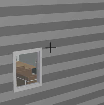

I have a building with a outside material with 2 different colours (as you see on the picture).
But what happens after rendering (lightworks) is that everything becomes one colour, grey.
How can I get it like it should be?
Thanks
Jonathan

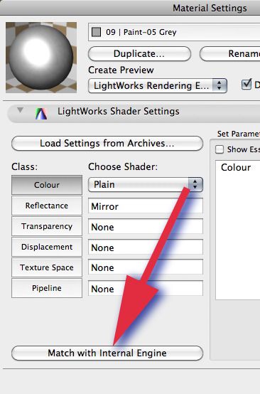

You can view/render the model in three meaningful ways:
OpenGL
Internal
and
Lightworks
The connection is not automatic.
In order for LightWorks rendered materials to match others, you will click the "Match Internal Engine" button
Dwight Atkinson
Thanks Dwight, that was the solution.
Thank you very much.
