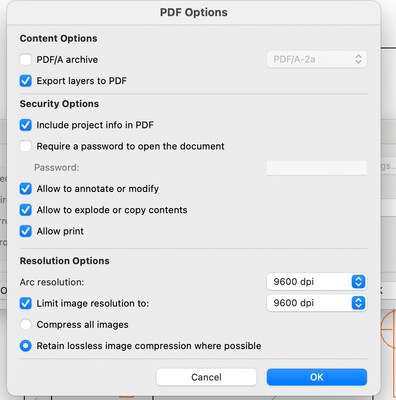

I have problem with Archicad saving layouts into pdf with darker colors and low quality photos/drawings. All looks good in archicad but once it process and save into pdf then it is way darker. And uglier. I tried saving in the highest quality as always 9000dpt. Nothing changes.
Someone mentioned it had to do with Archicad process setting that changed in 2022 (for some great priority reason other than preserving photo colors and quality).
To us , presentations are very important, first to present to client and second when we print. We are high-end studio and the last thing is to have our expensive software produce pdf like I did it quickly in some free online tool - when it comes to pdf. I appreciate everything looks nice in archicad but I need it to look nice also in front of clients as that’s what matters.

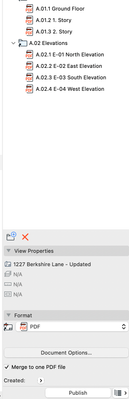

We generate pdf presentation through… we create the Layouts (which have around 40pages of visuals and drawings) and there save it into pdf (in the layouts window). There is option how the layouts should look (size, dpi, etc). So I  think this is publisher tool.

Understand, and thank you. I don't use any third party, just saving as pdf through archicad. Attaching print screen. I don't think this has anything to do with our MacBook, this is archicad set up. Otherwise could you advise?

No, I'm still not being clear / you're not understanding me.  MacOS has its own built-in PDF generator accessed via the Print dialog as in this screenshot.   Please take one of your layouts which has the dark / etc appearance issues and do this to create a one page PDF and see if it has the same issues you're seeing with the Archicad PDF generator...
Just display the problematic (from PDF point of view) layout and then File > Print...
