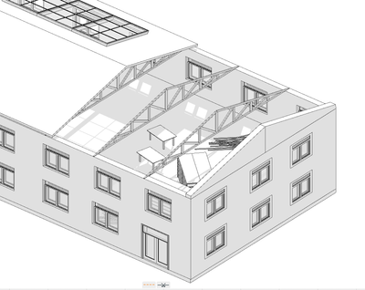

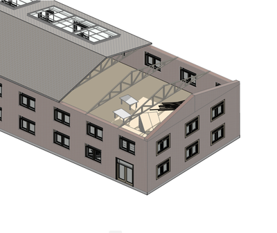

I can see window shadows in 3d model, but as soon as I open a 3d document those shadows dont appear, the shadow settings are on and I can see other shadows, only the window (glass) shadows are not appearing!

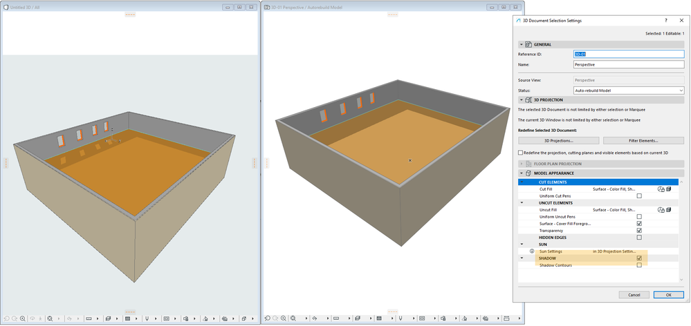

Did you turn on the Shadow checkbox in the "Model Appearance" panel of the 3D Document Dialog?
If I do that, Shadows will be generated for me.
However, it seems that there is still a limitation: glass panes will not be interpreted as holes in the Shadows in the 3D Document Viewpoint. I think this is the limitation of the Vectorial Engine, which the 3D Document Viewpoint uses. (The 3D Viewpoint can use Hardware acceleration.)
