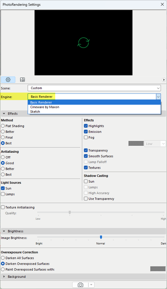

If you don't want the complexities of the Cinerender engine,
You can just use the Basic engine a renderer.
These materials are much simpler and are what you see in the 3D window.

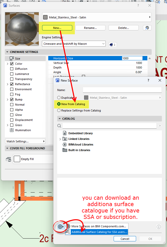

There are quite a few surfaces in the default template.
And if you have a select agreement or subscription, you can download an additional surface catalogue that has many more.
I am not saying they are perfect and not sure what the ones in BIMComponents are like.
Do you have the premium surfaces library loaded as well? I find I typically can get something that needs very little manipulation for things like metal or gloss from both GS libraries (I think this gives you around 500 surfaces to start from).
For reflective surfaces I found that I spent more time with the cinerender settings than the surface settings to get things looking right.
The out of the box 'scene' presets were pretty poorly optimised in the past, so I spent a lot of time figuring out which settings impacted render time, render quality etc to get something that renders quickly at decent quality.
