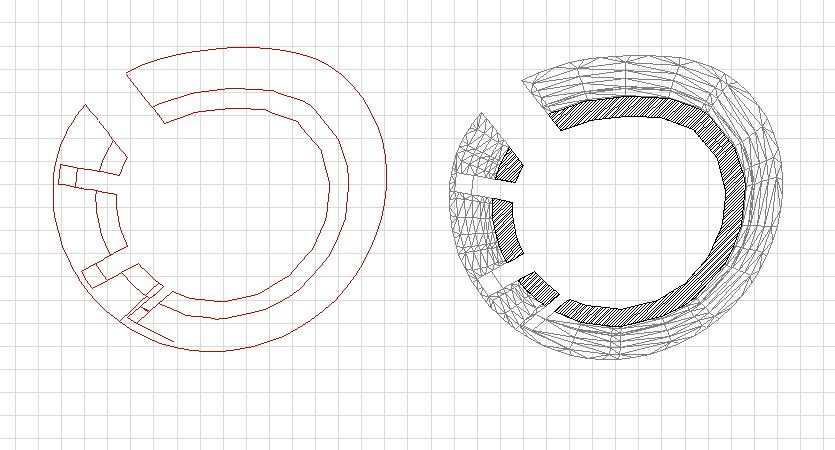

I am using Archicad 13 for a couple of months and i have recently discovered its potential to work with imported models from other softwares like Rhino or Cinema 4D. I am trying to find a workflow where i can create models in Rhino (and Grasshopper eventually) as complex envelopes/shapes for the exterior of the building and then refine and document the rest of the project within Archicad.
I believe this workflow has`nt been that easy before implementing the Cinema 4D Exchange plugin because of the storysensitive planview issue.
Now i just found out that a 3DS model imported in Archicad when sent to C4D and then back , will become storysensitive wich is great.
The problem is that it looses the "force smooth" property wich the 3DS import has.
My question is what is the workaround to add the smoothness property of the storysensitive object imported from C4D? I mean i would like the uncut surfaces to be seen without those edges of polygons, except for the countours. Just like the 3DS imported object but with cutplane sensitiity.
It has something to do with the 3D script pehaps? Or also in 2D script?
I am not proficient in gdl but i could manage to insert or change some lines.
Thank you !

I'm not sure about the import/export options/issues, but since it seems you can get the smooth part into ArchiCAD you can make it story sensitive and get the floor plan cutplane(s) correct with a bit of scripting. It's slightly advanced but actaully pretty simple.
Replace the graphic part of 2D script with the Project2 function. (There may be useful hotspots you want to retain.) This will cause the script to use a top view projection of the 3D as the plan symbol.
At the very beginning of the 3D script use:
IF GLOB_CONTEXT = 2 THEN
    addz plan_cut_height    ! derived from global parameters according to your needs
    CUTPLANE    ! in this form it simply cuts away anything above the XY plane
    del 1
ENDIF
The GLOB_CONTEXT condition means it will only run when called from the 2D script. At the end of the script you will need:
IF GLOB_CONTEXT = 2 THEN CUTEND
This ends the cutting plane.
You will also need to calculate the cutting height according to the home story, current story and floor plan cutplane global parameters. There may be a bit more tweaking to get the story sensitivity right. I don't know your exact requirements and it's been a while since I've written one of these.

Regarding the script for manually make it story sensitive, i have actually found a post here wich is even more flexible and reacts to the global cutplane settings. [url] http://195.144.20.106/viewtopic.php?p=138982&highlight=cutplane+gdl&sid=6554c87aef302866c74f8602654d...
First add a parameter for turning off or on the storysensitive function then in the begining of the 2D script should be this:
if StorySensitive then
   dummyvar = GLOB_CSTORY_ELEV
   project2 3,270,1   !  if you replace 1 with 2, becomes hidden line wich is what i wanted!
   end
endif
At the begining of the 3D script :
if StorySensitive and GLOB_CONTEXT = 2 then
   add 0,0,GLOB_CUTPLANES_INFO[1] + GLOB_CSTORY_ELEV - GLOB_HSTORY_ELEV
   cutplane
   del 1
   if CutBelow then
      cutbottom = max(GLOB_CUTPLANES_INFO[3]+GLOB_CSTORY_ELEV-GLOB_HSTORY_ELEV,GLOB_CUTPLANES_INFO[4])
      add 0,0,cutbottom
      mulz -1
      cutplane
      del 2
   endif
endif
And at the end of the 3D script:
   cutend
   if CutBelow then
      cutend
   endif
endif
I don`t know what dummyvar means. Anyway i succeded to make it cutplane sensitive but now i have to insert the foloowing parameters : uncut linetype
uncut pen
cut pen,
cut linetype
cut fill
Can you tell me where i should insert them and wich is the syntax?

Well i am almost zero in GDL experience but i`v just managed to understand a few lines and did some copy paste.
The smooth thing option is really a mistery. I wonder where it stays on the GDL script. Maybe by studying the C4D exchange script i could find an answer.
However the C4D script isn`t easy. Still, i think i have found the part where it defines the Projected view (wich means cutplane sensitive)

I am updating again. I have found that the "method" parameter in the Project2 {3} command, has nothing to do with the smoothness of 3D object.
So i guess this issue is related to the actual 3D script . I should compare the 3D scripts of the C4D and 3DS import object. Does anybody knows more about this thing?

You are right. The smoothness is determined in the 3D script. As I recall the Project2 {3} command just gives control over fills and pens for the plan view projection.
I don't know what the script from C4D import looks like but if it is binary then the options are very limited. If it is editable script it is theoretically possible to modify it but may be too difficult/problematic to be realistic.
