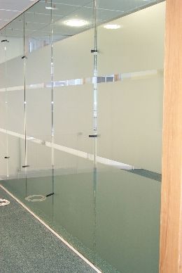

So I want to create a partitioning wall in a reaustraunt. I think that a glass wall will be a good choice but I don't want the glazing to be transparent for obvious reasons.
How can I make the glass translucent or ' frosted ' similar to the image below ( not my image )
Thank You

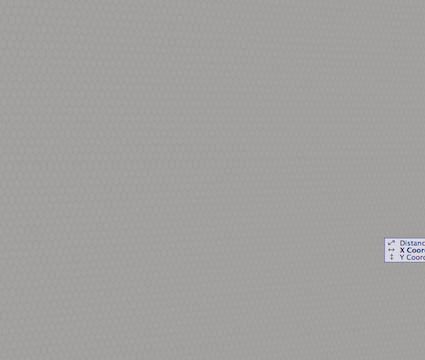

Following your instructions, here's what I got...
As you can see it isn't translucent but I did select the option in material attributes... unless it is the image I have used.

Hmm, Still not sure if it is right.
It does seem to be slightly more translucent in the photorender projection ( if this is where the texture alters the render ) in normal 3D it is just dots.

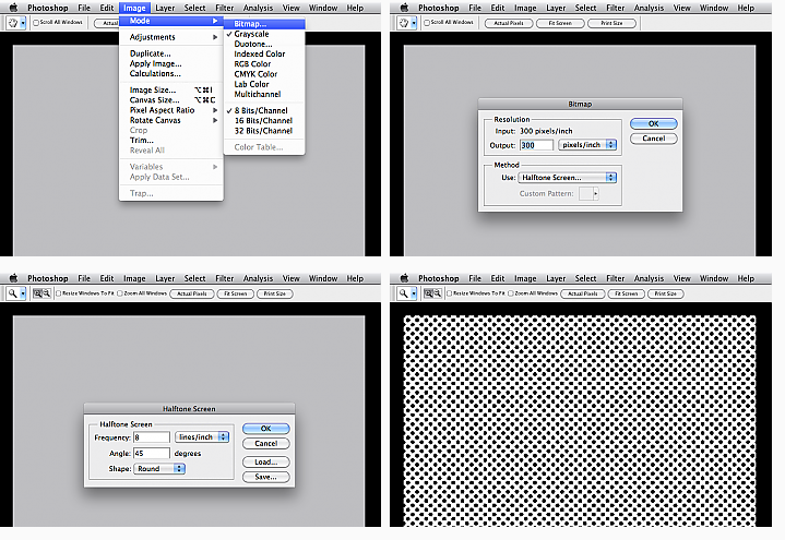

The dots image is a greyscale...
Here's how I did it:
Converted the dots image from Bitmap to Grayscale ( using a 25% grey, changing the frequency, angle and shape.
Duplicated he Background layer - The background layer cannot be transparent, so I created an new layer that can support transparency. I then deleted the first background layer, keeping the duplicate
New top layer selected, > Add Layer Mask
Option-clicked on the mask icon
Go to Image > Apply Image and apply the Layer image onto the Mask...
Clicked back on your Layer icon in the Layer palette. The dots should now show transparency (checkerboard pattern) in the background area.
Filled the Layer with White so that I have white dots on a transparent background.
Material settings
