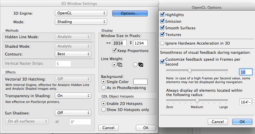

I'm guessing that something is amiss with your OpenGL window option settings.
There is an issue - described by Dwight in his Lightworks in ArchiCAD book - with Lightworks only being able to render transparency through very many surfaces - but not an issue in the OpenGL window that I know of.
See the attached screenshot and try this on your system. I copied a bunch of 'basic' walls of Glass material and put a column behind them. In OpenGL I see all of the walls, and see through all of them to the column. Is this possible on your system?
Note the image on the right from Lightworks...where the column is not visible because after a few walls, the remaining walls are not rendered as transparent.
Karl Ottenstein
Moderator Emeritus
Attached are the 3D Window > OpenGL settings I had for the image in the last post, in case any of the settings there look different from yours.
Contours (which I usually have off) and sun shadows (which I usually have on) shouldn't make any difference with the issue you're showing.

Karl,
Matched your settings and now the water shows more than before, but it's
sporadic. upon changing the view angle the water will either be there or it
won't. About 50% chance at splash. Better than before 0% chance when looking through glass.
