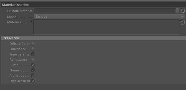

Now, thinking about it, because cinerender is coming from maxon, and cinema 4d what does is that you use a material to override all materials, and also seeing that there is no option to control the white model effect, I think AC is changing all materials for a single white material, but keeping the materials transparency for glass, so if I'm right then in order to see the shingles you will need to have real geometry and not a texture.
I think can be a good wish to have options in the white model effect to preserve different channels of the material as in Cinema 4D, like in the pic.

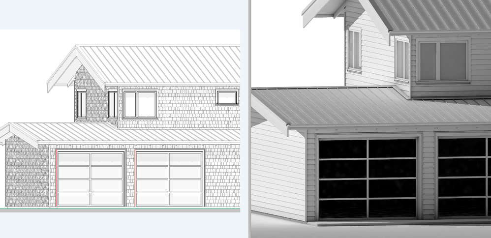

So I've had some back and forth with Cadimage and looking a little harder at their roof cladding, [thank you S2art], it would do the job very close to what I was after.......see down and dirty screen shot below of white render.
If only they can or will make that cladding applicable to walls I'd be in business. Any other Cadimage users out there want to chime in and ask for it, it might help!
