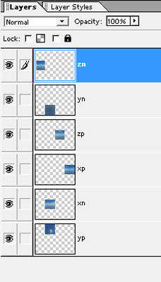

After downloading the images of the Skybox, open the 6 square images in a photo editing application. To create a Skybox, choose the "cubemap" image instead of the panorama-looking image with medium size: 4095 x 683 pixels:
Select the squares one by one and place them onto separate layers. Now you can arrange them just like it is shown in the image below. Rename the layers.

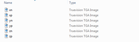

Step 3: Save the Images in .tga Format
The originally downloaded images might have .jpg, .bmp, or other image extension. Make sure you save the images in .tga format with the following names in order to be able to use them in BIMx properly.

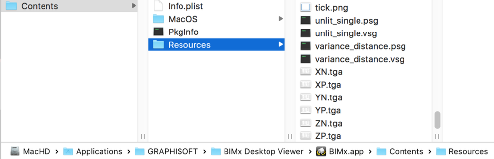

Step 4: Find the Skybox in the BIMx Folder
Go to the following location to find the default Skybox image of BIMx:
  • Windows: C:\Program Files\Graphisoft\BIMx Desktop Viewer\Data\Textures\Skybox
  • macOS: Applications\Graphisoft\BIMx Desktop Viewer\BIMx.app (Right Click - Show Package Contents)\Contents\Resources

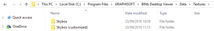

Step 5: Change the Skybox Images
The BIM Explorer application uses the images of this Skybox folder to display them as the background environment. To keep the original content of the default Skybox folder, rename it first. Place your new Skybox folder containing the 6 .tga images into the BIMx Textures folder and rename it to Skybox*.
After launching the BIMx desktop application, the modified sky images will be used automatically. The available backgrounds are listed in the Settings menu/ Background. *The Textures folder does not exist on macOS, make sure you back up the original .tga files before replacing by your customised files.
