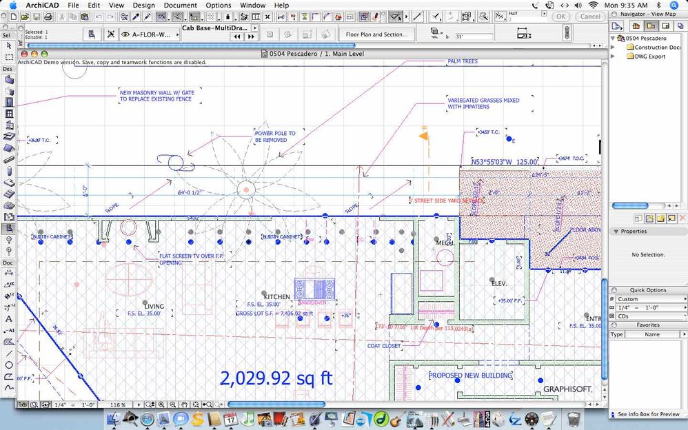

I can appreciate the presumption, but the posting is precisely because I have spent a lot of time inserting the new library parts into my "carry-over" projects. If I switch out the AC9 library for the AC10 library, I am left with very identifiable "missing parts" dots.
Gabor, the GUIDs may work for half of you, but for the other half, the program wants the name. If this process were "automatic", you would not see a posting on it.
It also seems illogical to me to say that file naming meant nothing, yet Graphisoft spent hours changing them all... The other frustration in renaming (for the user) is that it creates the presumption that the part is now somehow updated or changed. For instance, I do not notice any difference between "Book Shelf 01" from AC8 and AC10. And if I am correct, than why isn't this part still called "Book Shelf 01 8" or "7" for that matter? Why not help the user understand that this is still the same? Why should we need to open the GUID's for God's sake?!
At this point, the fastest thing for me to do is to open the .lcf and rename everything, instead of going into all the files, reinserting the parts, and resetting all the parameters.
