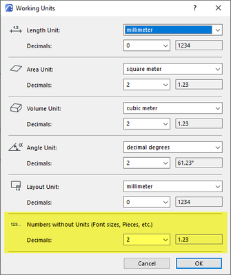

I am not sure about this, but is it the Working Units?
Calculation Units control lengths, heights, widths in the schedule, but as you are using expressions, these oddly are not classified as calculation units.
In Working Units there is an option for 'Numbers without units' which might include expression results.
But as I say I am not sure, but might be worth a try.
Of course the expression will have to be a number and not converted to a string.
AFAIK - expressions return values in calculation units. Within a expression, you can use any units you like and it will make the conversion(s). I believe the number unit selection will not add comma separators unlike the length, etc. measurements.

And I wasn't really thinking.
This is for decimal precision, not 1000's delimiter.
Gerry - Python perhaps easier than Excel.... unless you don't know the first thing about Python 😂
Barry - yes - Working Units will control decimal precision of those "unitless" numbers. So the software hook seems to be there. But does anyone *ever* need SF calculated to four decimal places? Silly. I'd rather have the "precision" in reports to distinguish currency from area, for example. With different decimal precision for different units...
But we need less of a sledgehammer and more of a scalpel. Better to have format control either within the expression itself, or at the level of a column in the schedule. Blanket settings for "all numbers, everywhere" ain't that helpful.
