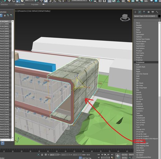

The material textures do not translate with the RVT export, however, MAX interprets the material definitions as independent material ID's which is great!. Besides, persons using 3ds max would be planning to use more premium materials and 3D assets anyway. As for the UV coordinates, just simply throw a UVW Map Modifier on your objects you want to have UVs in max, and even if you reload the 3D model, it WILL keep your materials and UVs!, ... and ... any modifiers you add in MAX!
