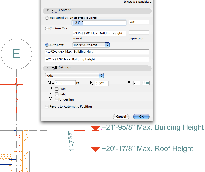

Your topic title is "Flexible Level Marker (Plan)" but it would seem that you're talking about level indicators in section/elevation. If this is indeed the case much, if not all, of what you ask for can be achieved with an object. The downside is that it will not associate to other elements so must be moved manually when building elements are modifed, but that's the case will all your other notes anyway and is a simple matter. The screenshot shows an object I made for this purpose. It has leading and trailing text but not the dual elevation you mention. If it's close to what you're looking for I'm happy to share it and you could modify it as needed.

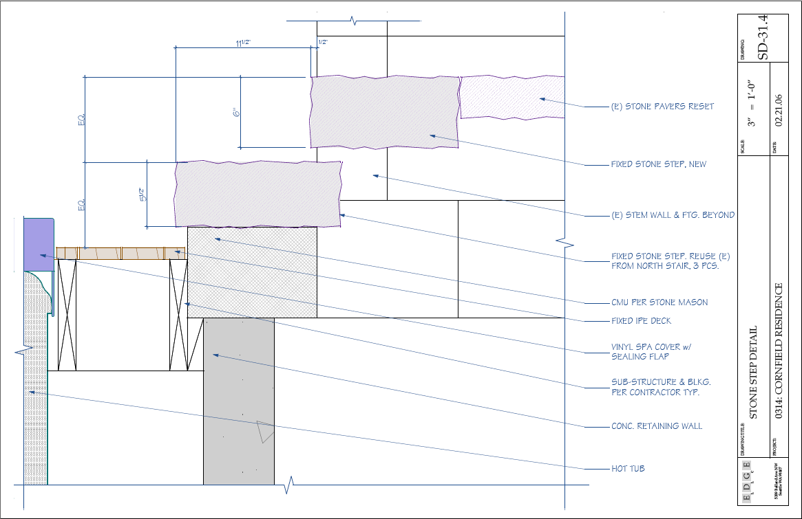

__archiben
[OT] geoff, are those detail call-outs replaced by 'archisketchy-ed' details at that scale? [/OT]
b e n f r o s t
archicad | sketchup! | coffeecup
Geoff Briggs
Mentor
Ben, this is a live section at 1:24 scale. The call-out points to a 1:4 detal cut from the section. It's main purpose is a roomier place for notes and dimensions. Since I presumed (correctly) that the structure described by the detail would change a few times it made sense to model everything so I wouldn't have to redo much after a rebuild. Because all the elements were modeled the detail needed only minor tweaks (e.g. more accurate profile of the spa and cover) which I put in a special layer so they would not be overwritten on rebuild. Thus the rebuild process become a simple matter of (re)deleting unwanted lines. Note, the break lines are objects with masks so I don't need to chop all the lines and fills or mess with an imprecise clipping polygon. Does this answer your question?

Another possible method is use a stretchy grid object (includes gridlines and story levels that you can snap dims to) for your sections, change the text in the level dimensions (NOT story markers) to 'custom' and then append your preferred prefix FF, etc. And get the dim to call the desired Autotext reference levels...
You will see the autotext allows you a number of level options, and the hotspot lets you shift around its location...
