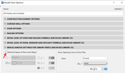

Minimal Space feature should have an on or  off  Toggle.  As it is now, you have to set each dimension to 0 in order to shut it off - doing it that way means you have to type in the dimensions again when you want to see it.  The other way to turn it off or on is with Model View Options,  but that turns all minimal space displays either on or off.  It would just be easier if we could also toggle it on or of in the object menu.

Hi Steve,
Thank you very much for sharing this great idea!
I am happy to say we took notice of this wish and I have added it to our Wish List database (please refer to it as IDEA-4397). Hopefully, our Product Management team will adopt this one in the future.
