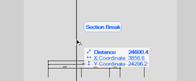

There are things that are caught invisible such as section break during section work.
LeeJaeYoung
There are things that are caught invisible such as section break during section work. I don't want it to be selected. I keep getting stuck at work.
AC27 on window 11
11 REPLIES 11
This has nothing to do with marker range lines in on-screen view options.
It is a right mouse click option in the actual section/elevation view.
@Barry Kelly Ahh, found it. Learned something new today! Honestly, I have never noticed it before. That will be a big help in my section views. Thank you. Unfortunately, turning that setting off still doesn't stop the ghost selection of the Marker range lines on plan.
