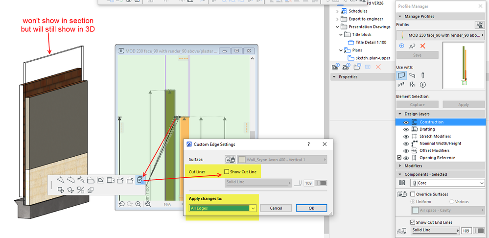

Is it possible in a complex profile of a composite Wall to create an air cavity (material ‘air’) and when you look at the Wall in 3D the air cavity has no contour lines, just blank. Even when the wall-cladding is higher/lower than the cavity.
oh…and the Wall has different parameters for height and width of the different skins. So everything is parametric.

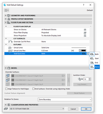

as long as the walls have the same surface inside and out then you will not see the join in elevation
you can tell the wall not to show ends where they join so they do not show in floor plan as well if you have errors.

Not that I am aware of..
The only way I know not to see the cavity in 3D is to not have a fill (building material) for it at all.
You can hide the lines in section.
also, the use of "Air" fills can wreak havoc with IFC translations. Air is a very special fill - to be used intentionally and carefully.
