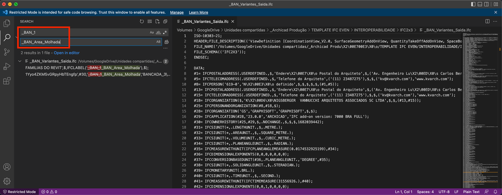

Step 1. The output property is generated for later IFC translation.
Captura de Pantalla 2023-04-27 a la(s) 9.28.57.pngCaptura de Pantalla 2023-04-27 a la(s) 9.29.13.png
Step 2. The IFC is opened from a text reader and the generated properties are replaced with the final properties.

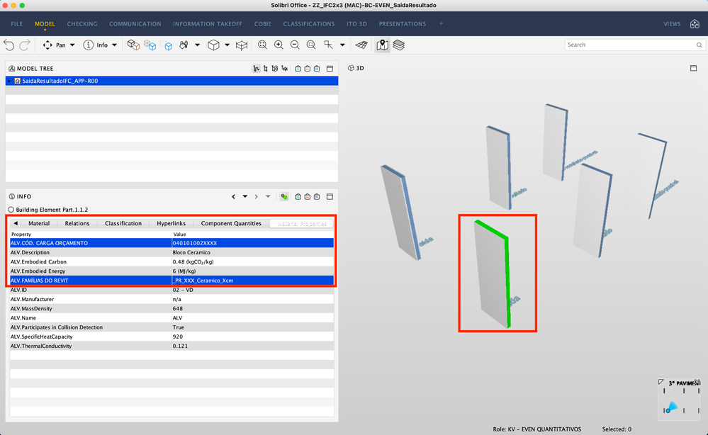

So, if I understand correctly, you have Building Material Properties, such as CODE or REVIT FAMILY NAME. When you export the Composite elements using these Building Materials as IFC, you want these Building Material Properties to be mapped to certain IFC Properties.
But, I suppose that you want to map the Building Material Property to the IFC Property of the Component, not the IFC Property of the Element. Right?
Could you post a screenshot of how would you like to see those Building Material Properties in the generated IFC file? Maybe a screenshot in Solibri or another IFC viewer?

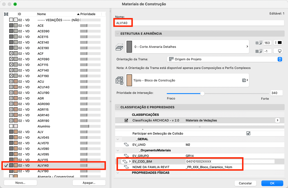

Suppose we have a general construction material (ALV) for all the cores with ceramic blocks, but depending on two parameters, CODE and REVIT FAMILY NAME, with values marked in "XXXX", "XXX" and in "Xcm" are parameters depending on its position (XXX = INT/EXT), its thickness (Xcm = 9/11.5/14/19cm) and the end of the code (XXXX = 0001/0002/etc.). So you would need to exchange those "X" of the item, for parameter values of the compound (system). The same with each lining (item) of the same composite wall.
before: the building material is called ALV and contains property values to be filled depending on its parametric attributes.
Captura de Pantalla 2023-04-27 a la(s) 16.36.19.pngCaptura de Pantalla 2023-04-27 a la(s) 16.37.40.png
after: the building material is called ALV115 and contains property values filled in from its parametric attributes.
