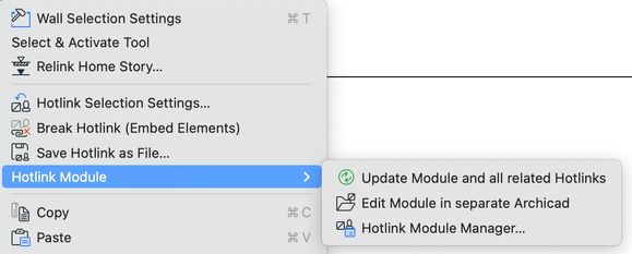

Placed-module update is not automatic with self-linked hotlinks, so you still need to go to Hotlink Module Manager after changing your sub-story content and click Update to update all placed instances... or right-click a placed module and click Hotlink Module > Update Module and all related Hotlinks as seen in this screenshot:
PS One more caveat besides manual update (or auto-update on re-opening the file):  the self-hotlink does not come from the live/open file, but from the last version saved on disk (or published by TW).  So, if you make changes to a self-linked module on negative story... you must save the PLN before doing the Update Module. 👍

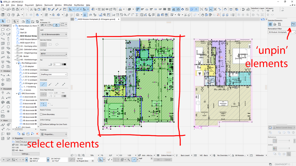

Stefan asked me in a PM to explain our method a bit more, rather than keep it in PM, I figured it might be interesting for more people.
Quick screen shot of the 'workplace'. On the top left of the navigator, you can see our saved view (MOD Module Werkplaats). After opening that, you scroll / zoom to the module you want to change, in this case 'PLG_A' (shorthand for floorplan A). We select the elements and then 'unpin' them on the top right, so they are no longer linked to the custom renovation filter.
Next, make your changes, you can use trace and reference to see the module in relation to the model. When you're done making changes, selec the elements again and then save (and overwrite) the module file. After that, 'pin' the elements back to the filter, update modules and you are done.
