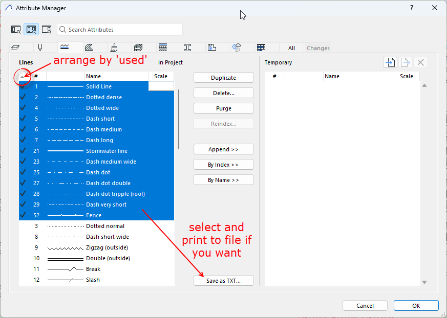

Are you aware that you can see all used attributes in the Attribute Manager already?
And if you need to you can select them and print to a text file that is tabulated so you can open it as a spreadsheet.
Pedro Melo
Yes, I'm aware. But I think it would be a nicer implementation to have interactive schedules with previews etc.
