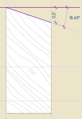

SeaGeoff
Ace
Absolutely essential, a glaring omission in the original implementation of Profile Modifiers. And I would add that angles could be defined by degrees or offset from a reference.
