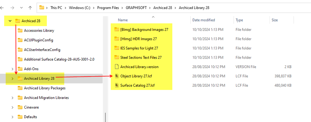

Open the 27 file in 28 and keep using the 27 library - oddly this library is found in a folder called 'Archicad Library 28', but it is the 27 library.
So just load that folder as you would have done in the past.

Also load the Migration Libraries if your job has used older libraries in the past.
This is exactly the same as before, except that you are using the 28 program.
