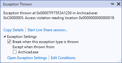

Hello, I've been experimenting on 3D Documents and I've encountered crashing when I use 'APIEnv_GetDocumentFrom3DSettingsID'. Then I checked and run the Database_Control example and it also crashes on that line ' GSErrCode err = ACAPI_Environment (APIEnv_GetDocumentFrom3DSettingsID, &dbPars.databaseUnId, &documentFrom3DType);'.

This is the exception detected by Visual Studio
I also tried running the AC25 addon and it works fine so this looks like a problem for AC26 API
