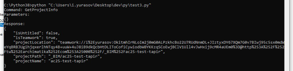

Is there any way to open Teamwork project with API?
I've managed to do the similar task with local pln files using the APIDo_​OpenID. It's interesting, as the IO::Location could contain both pln and teamwork paths, but I guess in the case of teamwork file it's local? However, when I'm extracting project info, I also have some encoded URI to the teamwork. Also, there is a APIFType_WGProjFile (Teamwork file type) in API_​FTypeID.
And is there any command to forcefully create a PLN backup on the server side?
