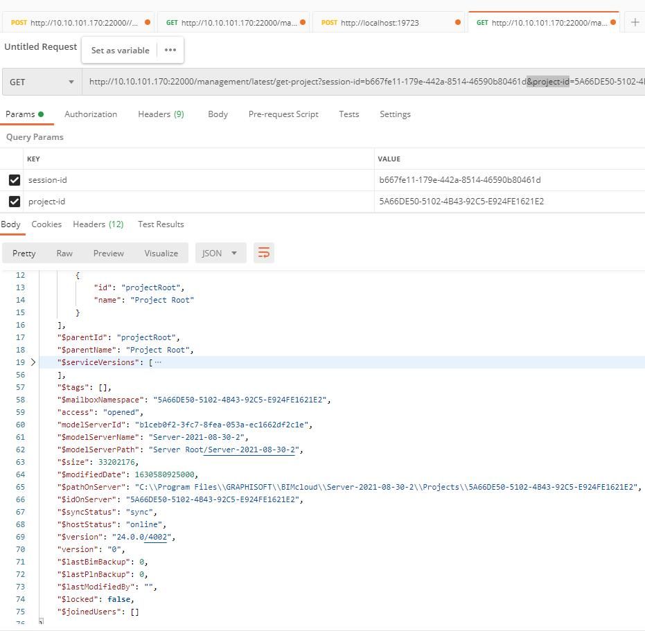

leilei
HI.
If you want to get all project information, you can try calling like this GET:http://ip:22000/management/latest/get-projects?session-id=xxxxx
If you want to get all project information, you can try calling like this GET:http://ip:22000/management/latest/get-project?session-id=xxxxx &project-id=xxxxx

Hi leilei,
Thank you for your comment regarding GET requests using Curl.
We have used a similar query:
http://vbimmanager:20000/management/client/get-resources-by-criterion?session-id=xxxx
to extract all possible information from the vbimmanger.
